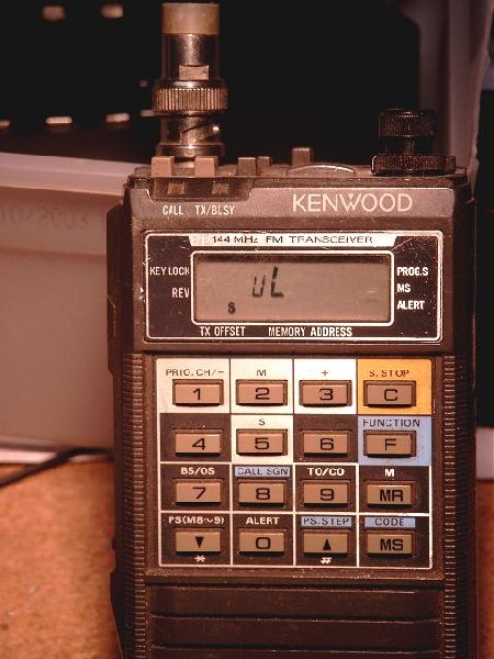

Hallo .... ik heb al jaren een TR2600E waar ik zeer tevreden over was maar helaas heeft hij het nu laten afweten, als ik hem aanzet komt er heel even "145.000" op het display en dan een soort melding "UL" .
Weet er iemand wat er met het ding aan de hand is? ik heb het back-up batterijtje reeds vervangen maar dat mocht niet baten.
73 .... Hugo ON6HN

Op de site http://www.radiomods.co.nz/kenwood/kenwoodtr2600.html zag ik het volgende. Wellicht helpt dit ook voor jou:
TR-2600A PLL Unlock Troubleshooting
The owners manual for the TR-2600A lists the lithium battery as a possible cause of the display showing UL. You may wish to check the battery, but realistically on a new radio this is probably not the reason for the unlock condition.
If the radio showl UL when first turned on you should perform the following test. This will help you to isolate the symptom:
1. With the radio turned OFF, press and hold the 5 key, and then turn on the radio. Release the 5 key. If the display shows a frequency indication you may have a pad X2 on the TX unit.
2. If there is no frequency display other than UL then proceed with step II.
3. You may also wish to check crystal X1 the Reference oscillator (10.240 MHz at pin 16 or 17 of IC1.)
There are several other points to check.
1. Check trimmer capacitors TC , TC5 and TC6. If you press on the trimmer and the UL dissappears replace the trimmer.
2. Check pin number 18 of IC1, it should be 5.4 - 6 vdc.
a. If the voltage is over 6.5vdc replace Q17, Q18, and IC1.
b. If the voltage is less than 5vdc replace Q17 and Q18.
3. Check the CLK signal at the flex pc board connector, and pin 10 of IC1.
a. The CLK signal should be aprox 4 - 4.4 vdc.
Pin 10 should be aprx. 0 - .2 vdc.
b. If pin 10 is high check Q16, and for cold soldering on the flexible pc board between the keyboard and the RX unit.
4. Check the alignment of the PLL section, as given in the Service manual.
5. Press the RESET pushbutton on the back of the radio.

Hallo Tjalling .... bedankt voor de info, ik ga dat eens uitproberen, ook bedankt voor de handleiding, die heb ik nooit gehad, maar de servicemanual heb ik wel.
73 .... Hugo ON6HN

Hallo Tjalling .... het probleem is opgelost, ik heb heel even aan de 2 trimmers (TC5 en TC6) gedraaid van de VCO waarvan sprake in het artikel en waarachtig verdween de "UL" van het scherm en kwam er "145.000" te staan, de portabel werkt nu weer als voorheen .... en zeggen dat ik daarvoor de portabel al een 3-tal jaar niet meer had kunnen gebruiken.
Hartelijk dank voor de tip.
73 .... Hugo ON6HN
Re: TR2600E Kenwood portabel
Fijn om te horen Hugo... toch een beetje verlopen door ouderdom denk ik. Maar nu kan ie weer even mee... :)
